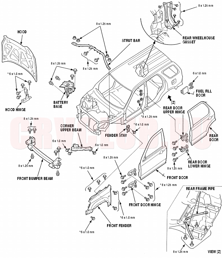

NOTE: To adjust the alignment of the hood, the doors, and the tailgate, refer to the CR-V Shop Manual.
6 x 1.0 mm: 9.8 N·m (1.0 kgf·m, 7.2 lbf·ft)
* 6 x 1.0 mm: 18 N·m (1.8 kgf·m, 13 lbf·ft)
8 x 1.25 mm: 22 N·m (2.2 kgf·m, 16 lbf·ft)
* 8 x 1.25 mm: 29 N·m (3.0 kgf·m, 22 lbf·ft)
