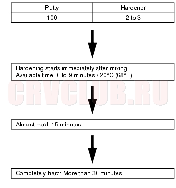

The use of a special polyester putty for PP bumper is described here:
- Filler
- Mixing Ration :
- Drying Time:
Air dry 20°C (68°F) 3 hours Force dry 60°C (140°F) 30 minutes

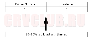

- Primer surfacer
- The primer surfacer is used to protect the PP resin surface and fill cavities of flaws befort the intermediate coat and top coat.
Use the 2-component type primer surfacer (grey).
- Mixing Ratio:

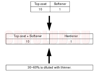

Use the 2-part polyester urethane top coat. Top coat is also used for an intermediate coat.
- Mixing Ratio:
- NOTE: Be sure to mix the correct amount of the hardener and softener.
- NOTE: Use a spray gun to apply the paint. Do not use a brush.
- Drying time:
Air dry 20°C (68°F) 6~10 minutes Touching by the finger. Almost hard 12~14 hours Completely hard 96 hours
- Force dry the intermediate coat and top coat.
- NOTE: Mix only an amount that can be used before it hardens.

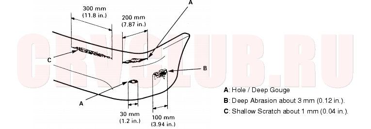

The following shows refinishing methods to various types of paint damage or defects. Be careful not to deform and damage the parts when force drying.
6-19
Preprocessing of Painting

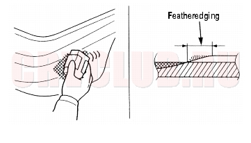

Shallow Scratch:
Use a flexible block and #240~#400~#600 sandpaper

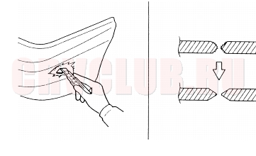

Hole / Deep Gouge:
Cut out and make any torn or burred area flat.
Use a knife, flexible block and #180~#240 sandpapers.

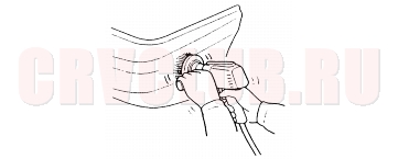

- Air blowing / degreasing
- Clean the damaged area thoroughly.
Use alcohol, and wax and grease remover.

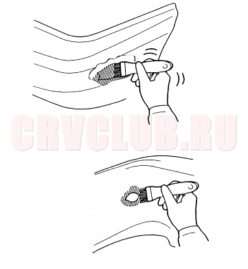

- Primer is used to fill cavities in the putty and primer surfacer.
- Spray primer on the exposed area.
- Spray the 2 to 3 coats of primer on 2 to 3 coats over the area you applied putty.
- Apply primer to the back of the bumper if the damage is a tear or hole.
- Bumper primer
- Warm the primer if the ambient temperature is below 50°F (10°C).
- Follow the bumper primer manufacturer's instructions.
- Use a spray gun and a brush.

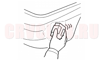

- Filling / Sanding

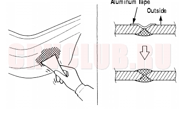

- Apply putty to repair any holes or deep gouges.
- Apply the putty on the damaged area in 2 to 3 steps.
- Glue aluminium tape on the outside of the bumper, and apply putty from the other side of the bumper.
- Remove the aluminium tape after the putty dries, apply putty from the outside, and fill the hole.
Use a special polyester putty (Reference) and a putty knife.

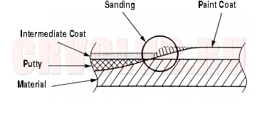

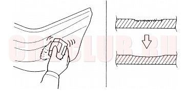

- Sanding
- Sand the surface evenly, particularly at the area where the PP material and putty meet.
Use a flexible block and #240~#400~#600 sandpaper.
Use alcohol, a tack cloth, and wax and grease remover.

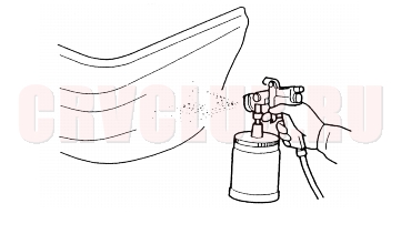

- Spraying primer surfacer
- NOTE: Spray the bumper primer (see page 5-13) on the area where the PP material was exposed and around the putty.
- Spray the primer surface wider then the putty and painted surfaces of bumper primer.
- Spray 2 to 3 coats to get 20 tot 30 microns of thickness.
- Use the 2-component type primer surface (gray) and a spray gun.
- Follow the materials manufacturer's instructions.

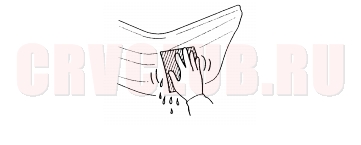

- After drying, wet sand the area of the intermediate coat.
Use the #600 sandpaper. NOTE: Do not use #600 or less.

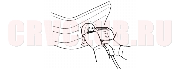

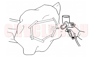

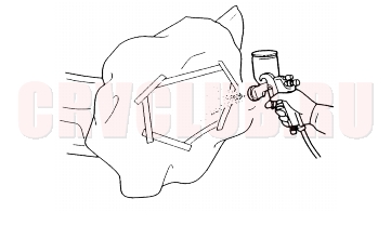

- Masking
- Mask the area surrounding the damage to protect is from the intermediate coat overspray.
- Spraying the top coat enamel
- Spray the top coat enamel over the surface until the primer surfacer is fully covered.
- Spray 2 to 3 coats to get 15 to 25 microns of thickness.
- Use the 2-part polyester urethane top coat enamel and a spray gun.
- Mix the top coat enamel with the additive and solvent in the correct ratio.
- Follow the top coat manufacturer's instructions.
- Drying
- NOTE: Take care not to let the heat lamp deform the bumper during the drying process.
- After spraying top coat enamel, allow for 5 to 10 minutes of normal drying, then force dry it with infrared lamps or other industrial dryer.
- Clean and degrease the surfaces where the masking tape will be attached.

- Masking
- Mask the area surrounding the damage to protect it from the top coat overspray.
- Spraying top coat enamel /clear coat
- Spray 2 to 3 coats in double coat until the intermediate coat is fully covered.
- NOTE:
- Do not cover the surface with one heavy coat.
- Apply several thin coats.
- After spraying the top coat enamel, allow for 5 tot 10 minutes drying time before you spray the clear coat.

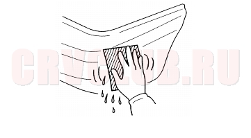

- Wet sand to remove any imperfections.
Use a flexible block, soap, and #2000 sandpaper.
- Using a buffer and compound, remove any polishing marks made from the sandpaper.

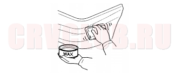

Wax the finished area.
