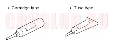

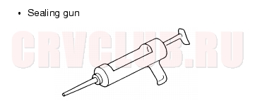

SEALER
3M #08892 (internal) 3M #08893 (external) TOOLS
To be applied to under-floor and wheelhouse.

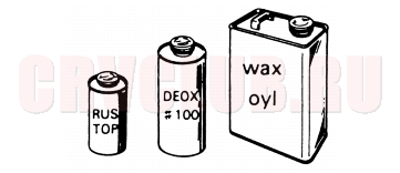

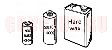

Nox-rust 409-20S Solton 1000S
ANTI-RUST AGENT
To be applied to weld joints inside the body panel.
Rustop Deox #100 Waxoyl

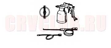

SPRAY GUNS
Use the correct gun for the agent being used.
Use of a pressure type spray gun is recommended when work involves a considerable numer of vehicles.

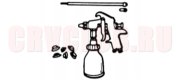

For nox-rust 409-20S / solton 1000S

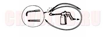

For rustop

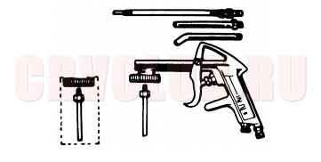

For deox #100
