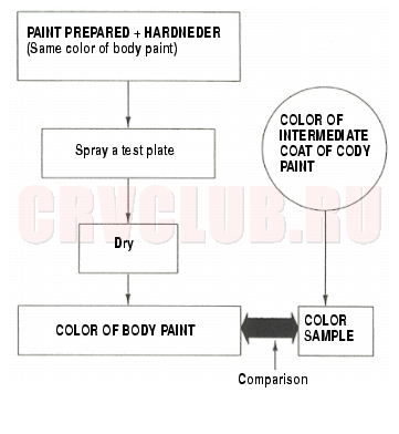

Repair of 3-coat pearl paint coat requires different procedure from that of metallic paint coats.
Determination of color:
- Sand the damaged paint coat until the intermediate coat appears.
- Polish the exposed paint coat, then compare is color with the color sample provided.
- Prepare a paint based on the color sample selected according to the instructions.
- After preparing, check that the paint prepared matches the color sample selected in step 2 above.
- NOTE : On pearl paint, the color of the intermediate coat will determine the final color of the paint repair.
