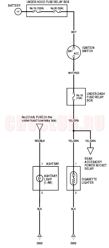

Circuit Diagram

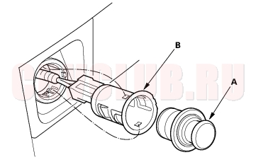

Replacement
  1. Remove the cigarette lighter (A) and socket (B).

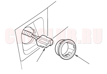

  2. Disconnect the 2P connector (A) from the socket.
  3. Remove the ring (B) from the dashboard.
