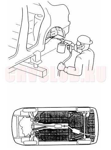

Undercoat:
WARNING
  • Wear goggles or safety glasses to prevent eye injury.
  • Ventilate when spraying undercoat.
  • NOTE:
  • Mask the exhaust system, oxygen sensors, and suspension mount areas to prevent them from the undercoat overspray.
  • Follow the undercoating manufacturer's instructions.

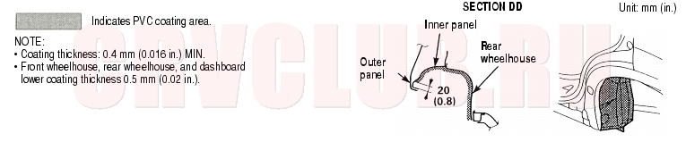

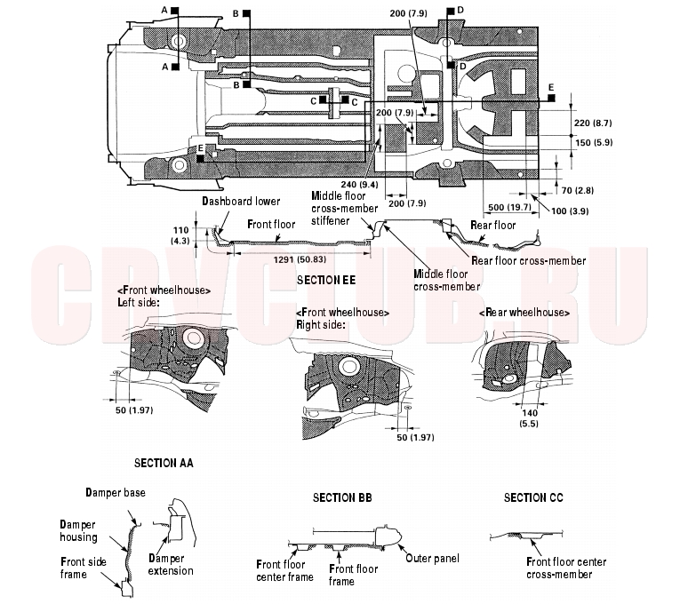

    1. Clean the body with wax and grease remover before the undercoat is sprayed.
    2. Apply the undercoat to the front wheelhouse, rear wheelhouse, and undersides of the front floor and rear floor (see page 5-14) .
    3. Coat the bottom of the fuel tank.

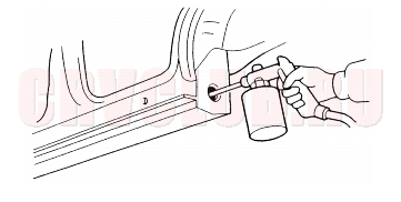

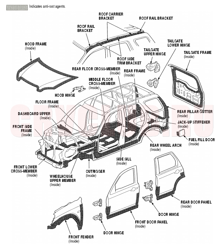

    1. Before applying an anti-rust agent, thoroughly clean the area to be coated with a steam cleaner, etc., and let it dry. Waxoyl may be applied to wet surface.
    2. Apply anti-rust agent from the installation hole and the access hole of parts in the outer panel and the frame (see page 5-15) . Spray the anti-rust agent sufficiently until the excess amount oozes out when filling the side sill.
