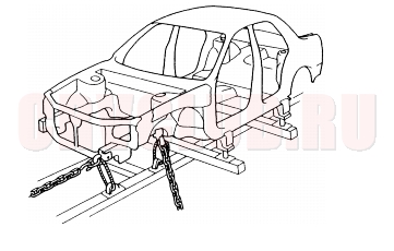

- Connect the frame straightener to the vehicle body.
- The side sill is flangeless to allow reshaping by pulling it out.

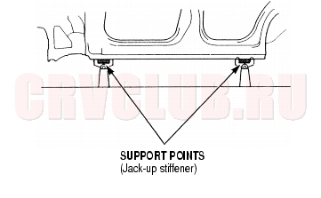

- Use the horizontal pinch welds for anchoring the vehicle.
- Pull out and straighten damaged areas.

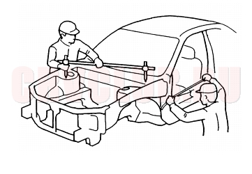

- Check that the part of the body is more or less restored to its original shapes. Check the original positions using the body dimensional drawings.
