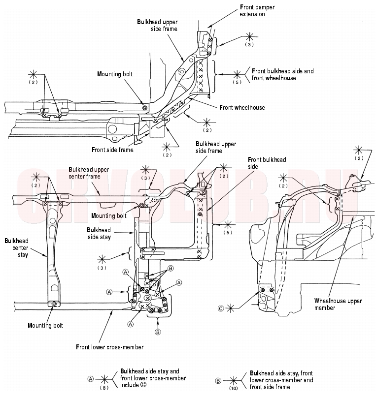

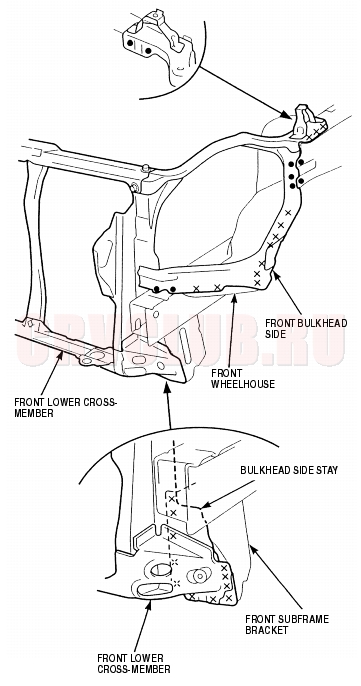

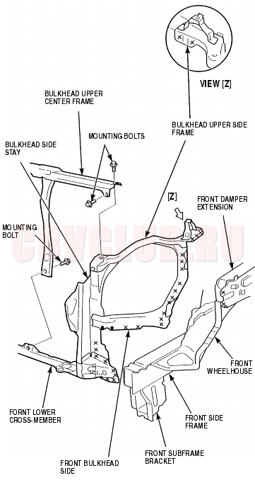

|   | Replacement3-1 Front Bulkhead 3-2 |   |   |
Front Bulkhead 3-2
Mass Production Body Welding Diagram
Removal 3-3
Installation3-3
- Set the new front bulkhead and wheelhouse upper extension into position, and measure the front compartment diagonally. Check the body dimensions (see section 4) .
- Tack weld the clamped position.
- Temporarily install the hood, front fender, headlight, and front bumper and check for differences in level and clearance.
- Do the main welding.
