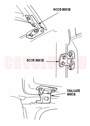

- Check the clearance of the door, hood, tailgate, and adjust if necessary.
Check the operation of the parts and make sure the doors lock securely.
- Apply the sealer to the hinges of the hood, door, and tailgate.
- Adjust the wheel alignment.
- Check the windows for water leaks.
- Clean the passenger compartments.
